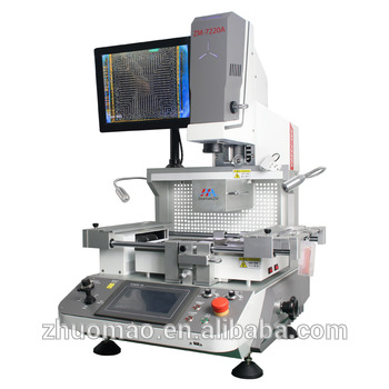

| T42 | <RealDanct12> by electronics, i mean you can put a msm8937 to a msm8940 phone and expect a upgrade | 10:22 |
| asriel | <T42 "<RealDanct12> by electronics, i "> LOL we do have a discussion about this on danctnix's channel | 10:24 |
| asriel | Even if it works, just buy a new phone instead | 10:24 |
| asriel | Replacing the chip requires some very expensive tool that a hobbyist can't afford | 10:25 |
| * asriel uploaded an image: image.png (120KB) < https://matrix.org/_matrix/media/r0/download/kde.org/NjGqivJCbdMEMItUXcnzsTuH > | 10:25 | |
