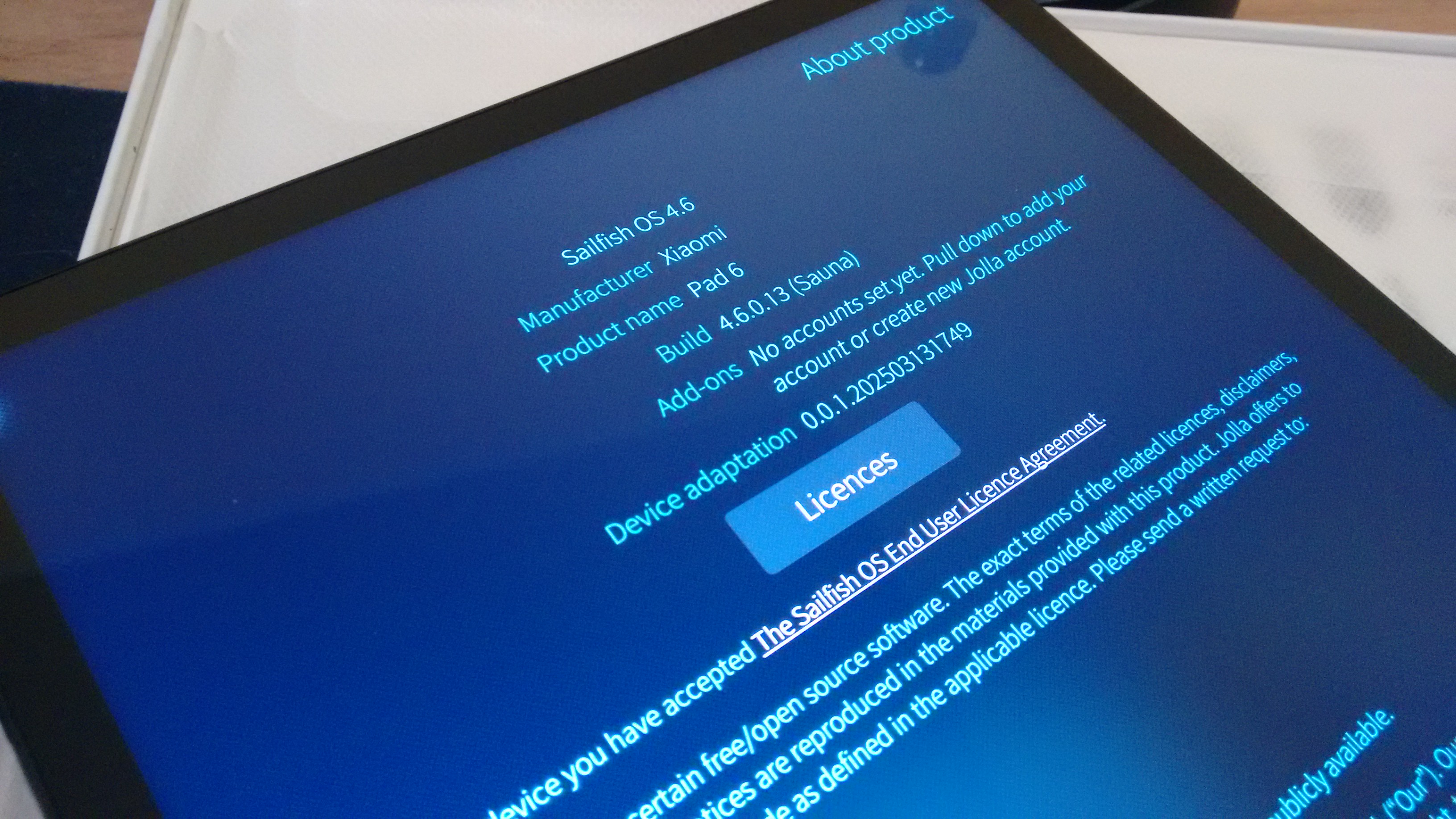

| Mister_Magister | mal: have you seen the screenshot from it yet? | 18:07 |
| mal | no | 18:07 |
| Mister_Magister | https://pbs.twimg.com/media/GmA5CjaXQAAgKHJ?format=jpg&name=4096x4096 feast your eyes :P | 18:07 |
| Mister_Magister | in past it had both eventsview and main view together | 18:07 |
| Mister_Magister | in two columns | 18:08 |
| Mister_Magister | i guess that was simply removed | 18:08 |

| Mister_Magister | yeaha in wifi details i see ip but in developer settings/about page I don't | 22:37 |
| Mister_Magister | well about page shows mac not ip but anyway | 22:37 |
